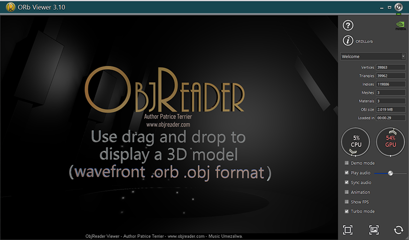

ORV_64 Version 3.20 - the .ORB challenge
« Reply #1 on: August 26, 2025, 12:23:06 pm »
About ORV_64 v3.20
(sample app for embedding ObjReader via ORDLL64.dll.)
What it is
ORV_64 is a complete C/C++ (VS2022, x64) example that hosts the ObjReader engine through ORDLL64.dll.
The DLL exposes a focused C API, just enough to create a viewer window, load a model, animate it, and query stats.
So you can render ObjReader content inside your own application UI.
What ORDLL64.dll is
  • The embeddable runtime of ObjReader (Win64).
  • Owns the renderer, model loading (.orb, .obj/.mtl), animation timer, and optional audio sync.
  • You supply the top-level window and message loop; the DLL creates and manages its child viewport.
Why v3.10 matters,  native .ORB compatibility
  • Cuts startup time (no text parsing/reindexing).
  • Reduces disk size for large meshes.
  • Simplifies packaging: ship model.orb + textures in the same folder.
Your code can prefer .orb and automatically fall back to .obj when needed.
Typical integration flow
  • Create your main window (CreateWindowExW).
  • Call OR_CreateWindow(...) to create the viewer child HWND.
  • (Optional) OR_SetSwapInterval(TRUE) for V-sync, OR_TimerEnable(TRUE) to animate.
  • Load a file via:
Code: [Select]
OR_ProcessCommandLine(L"path\\to\\model.orb");
  • On WM_SIZE, resize the child window.
  • Populate your UI with getters (OR_Vertices(), OR_Triangles(), …).
  • Offer controls: OR_ViewReset(), OR_Get/SetAudioVolume(), OR_Screen_Shot().
  • On exit, call OR_CloseAll().
API at a glance (what you’ll actually use)
  • Create/host: OR_CreateWindow, OR_CloseAll
  • Open model: OR_ProcessCommandLine (accepts .orb and .obj)
  • Animation & timing: OR_TimerEnable, OR_GetAniTick
  • Display options: OR_SetSwapInterval, OR_ViewReset, OR_Screen_Shot
  • Info for UI:
    • OR_Version, OR_ObjFileName
    • OR_Vertices, OR_Triangles, OR_Indices
    • OR_Meshes, OR_Materials, OR_ObjSize, OR_LoadTime
    • OR_DetectGPU, OR_GPUinfo, OR_GPU, OR_CPU
  • Audio: OR_GetAudioVolume, OR_SetAudioVolume
  • ORV_64 Version 3.20, is attached to this post.
« Last Edit: September 24, 2025, 03:23:58 pm by Patrice Terrier »
